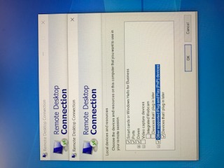

So I tried your Windows 10 Pro solution steps but when I choose Local Resources/More under my remote desktop connection.
I don't see my 3D Connexion device. It just shows Other Supported Plug and Play Devices, Devices that I Plug in Later.
See attached image. What am I doing wrong? Really need to figure this out. Thanks in advance!

So I tried what you suggested but it did not show any devices or 3D mouse under the Local Resources of the Remote Desktop Connection. See image. I really need to get this to work. What am I doing wrong? Thanks in advance!
Re: Remote Desktop use of local Space Navigator
Do you have drivers installed on both machines?
