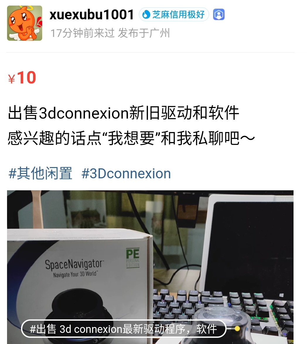

Ever since the redesign of the whole 3Dconnexion website, it's not possible to start a 3DxWare driver downloading by clicking the mouse left-button on https://3dconnexion.com/cn/drivers/
As a result, some sellers are trying to charge 10 Chinese yuan(1.27 Euros) to people who're looking for 3Dconnexion 3DxWare driver(as well as legacy drivers). Can anything be done to improve the driver download button on your website? :!:
