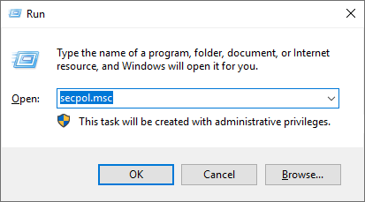

Try follow my advice:
Keyboard Win+R
Input secpol.msc, run as Administrator
Go to Local Policies>security options>
Make sure to disable "User Account Control: Run all administrators in Admin Approval Mode"

luping wrote: Mon Apr 05, 2021 2:50 am Try follow my advice:
Keyboard Win+R
