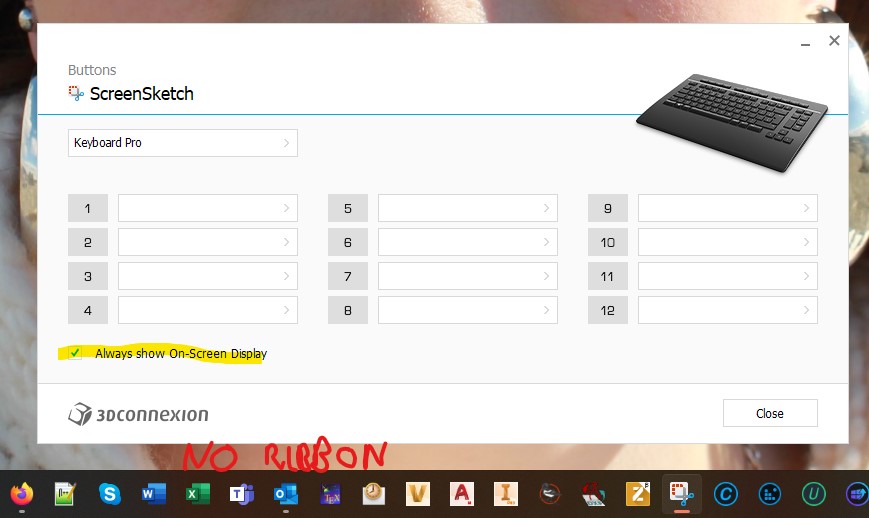

You mean the 'Always show On-Screen Display' option in the 3Dconnexion Settings panel's buttons assignment pop-up window? Please add some sort of screenshot to your reply for easy understanding...
Skjermbilde 2021-12-20 075845.jpg (68.35 KiB) Viewed 22783 times
Box is ticked, ribbon is gone. Got a reply from support describing how to do a clean reinstall as well. That worked for five minutes before it disappeared again.

I don't know why IObit Advanced SystemCare, IObit Uninstaller, IObit Smart Defrag is running actively in the background...are you worried about operating system junk and file fragmentation?

The other application on the system tray region I see may be IObit Registry Cleaner. I just don't know why they are all running actively in the background...

No they ain't running, I just have the icons on the taskbar. But yes; Windows has a remarkable ability to produce its own crap and never clean up after itself (in addition to a whole lot of other programs that seem to have that ability as well), and it has been that way since Windows 95. Hence the cleanup apps.
