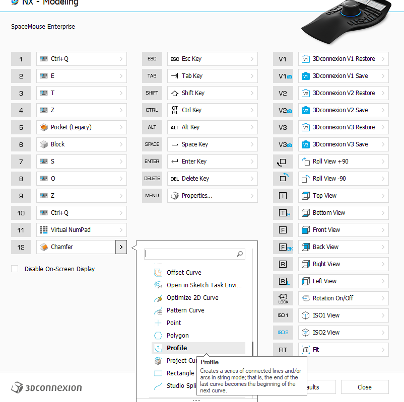

I just bought SpaceMouse Enterprise and was trying to configure it in order to use with Siemens NX 1872. Everything works fine, except buttons configuration. When I try to assign new functionality to any of the buttons, I get error like this:
It happens only, when I try to assign funcionality of buttons from NX's ribbon. For example, when I assign to a button funcion "Virtual NumPad", it's fine. When I assign letter "z", which in NX stands as a shortcut for funcion "Profile" in sketching mode, it's fine and everything works as expected. When I try to assign function "Profile" directly to a button (NX->Insert->Sketch curve->Profile) I get the error.
It's happening with any function from NX (it's not connected to being in sketching mode).

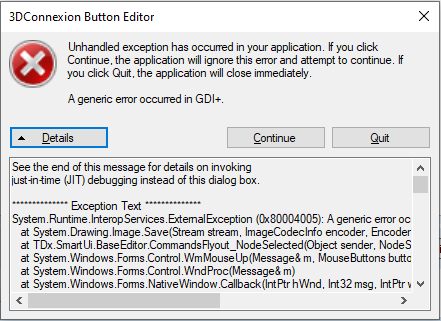

Details from error window:
See the end of this message for details on invoking
just-in-time (JIT) debugging instead of this dialog box.
************** Exception Text **************
System.Runtime.InteropServices.ExternalException (0x80004005): A generic error occurred in GDI+.
at System.Drawing.Image.Save(Stream stream, ImageCodecInfo encoder, EncoderParameters encoderParams)
at TDx.SmartUi.BaseEditor.CommandsFlyout_NodeSelected(Object sender, NodeSelectedEventArgs e)

Same here, NX 1996

Thank you for reporting this issue here.
We have logged the bug as WIN-992 and a fix is expected to be included in the next driver update, version 10.8.5.

Regardless, if you can reproduce the crash, then it is likely the plug-in is working properly (the bug is in a driver GUI program, not the in plug-in).
Yes, my error message is like those screencaptures above, same everytime and with both NX installations. I think it's driver related, but let's see when the driver gets the update.
