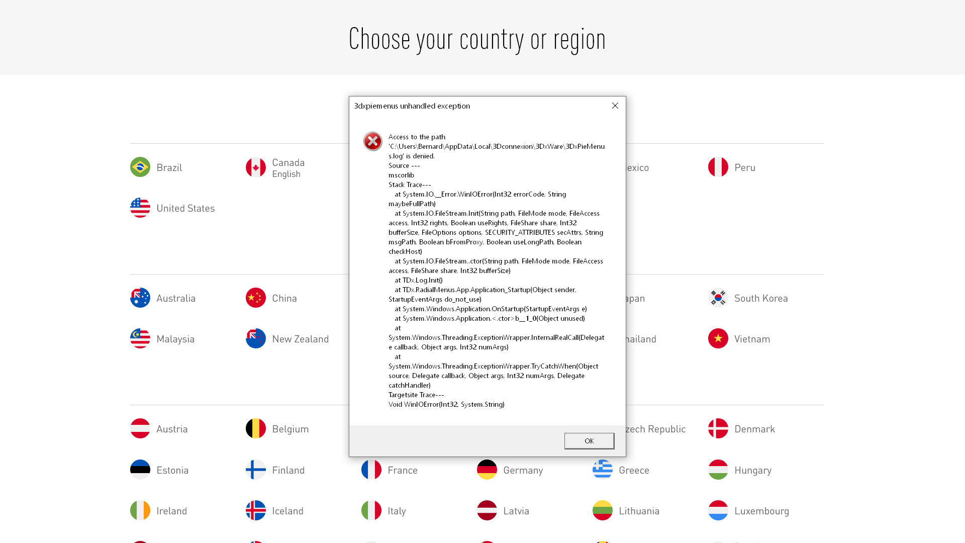

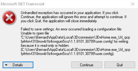

I've recently been getting this error warning. It's somehow related to the 3DWare but it doesn't affect the performance of my SpaceMouse. What's going on here? I already updated the driver to 10.8.7 but I still get the same warning.

I would delete that .../3Dconnexion/3DxHome* directory and try again.

Must be something wrong with your system's .Net Framework Runtime, try to install .NET Framework 4.8 Runtime.
