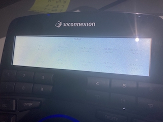

Hi, I installed my new Enterprise and all was fine for a few hours. The next day the screen on the Enterprise was very disrupted and I could and still can only just read the application heading and non of the button operations. I have reinstalled the driver a number of times and have down graded the driver as suggested by some older posts on here. However it has been to no avail. Is the product faulty? Should I send it back to Amazon and get a new one or is this a driver issue?

Can you share a photo of the screen?

I have posted a pic. I was in communication with the support from the main website and he asked me to use the 'Display" icon or button in the enterprise settings, however I do not have any such icon or button or anything that I can adjust the LCD screen with. I hope this helps.

It's difficult to tell what's being shown on the SpaceMouse Enterprise display. You may want to take a picture without the flash.

thanks for your input, there is no flash on the camera - one can see a light reflected, which is the office light. However what you see is a true picture of the actual display. it is barely seen and very disrupted. unfortunately I do not have a windows machine that I use or in the household. Is that all the advice you may have? is it a hardware or software problem in your opinion?

ilion8 wrote: ↑Tue Dec 13, 2022 7:28 am Is that all the advice you may have?
I'm afraid so. The image is too poor to be able to tell anything.
That's what I was trying to determine when I asked for a picture but you can also try disconnecting and reconnecting the device with everything running.
If the display image comes back again as bad as before, I would think it is a hardware problem but -- I stress -- this is only an educated guess.
