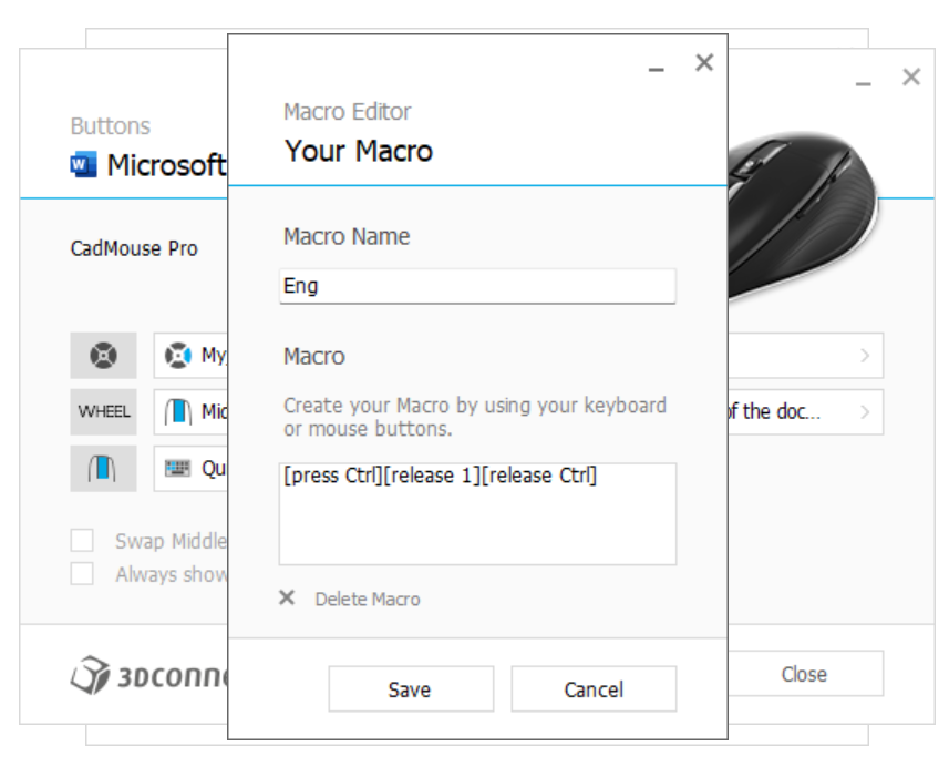

Hi All,
3Sconnecxion software does not allow me to create macros that look like Ctrl+1 or Ctrl+2. As I press Ctrl+1 combination the Macro box shows [Press Ctrl] and [release Ctrl]. However, it does not show [press 1]. It shows [release 1] only.
It works with Num-Lock numbers, however, my macros require the numbers from the keyboard, and I cannot create the due to that glitch.
Any suggestions?
Screenshot 2022-12-26 130758.png (108.1 KiB) Viewed 5276 times

Don't use the "macro editor" panel. Instead enter the shortcut directly in the button input field (click and the text changes to "Type a shortcut...").

I still cannot create a macro for Ctrl+1.
As I press it directly in the button input field, it saves Ctrl only.
Any other types of key combinations work.
Only particular combinations Ctrl +1, Ctrl +2 and Ctrl +3 do not work.
Even CTRL+4 and larger numbers work.

morkeleb wrote: ↑Tue Jan 03, 2023 7:44 am Only particular combinations Ctrl +1, Ctrl +2 and Ctrl +3 do not work.
The system is capturing the Ctrl+1, ..., Ctrl+3 shortcuts. In all likelihood, you have defined a system-wide shortcut to open an application or similar. This means the system will handle the shortcut and the "3Dconnexion Properties" program never gets notified of any key sequence events.
Disable the "Ctrl+1", etc, and only then map them in "3Dconnexion Properties". Afterwards, you can re-enable the shortcut system-wide and it should all work.

That's correct. I use Ctrl +1, Ctrl +2 and Ctrl +3 as Windows input language hotkeys.

I ran into this issue trying to bind Ctrl+Num 1. My workaround was to edit the application xml file in %appdata%\3Dconnexion\3DxWare\Cfg.
I added a MacroEntry for Ctrl+Num 1 right before the </MacroTable> tag that imposes the Control modifier.
Note that 59 is the HID Usage Code for Num 1.
Code: Select all
    <MacroEntry>
      <ID>Ctrl+Num 1</ID>
      <KeyStroke>
        <Modifiers>
          <Modifier>Control</Modifier>
        </Modifiers>
        <Key>59</Key>
      </KeyStroke>
    </MacroEntry>

Ctrl+Num 1 appears to have a different issue, in that it doesn't seem to have a system function, but Num 1 doesn't show up in the Macro Editor command when used with a modifier.
