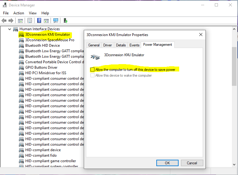

I believe I may have found a solution. Previously my 3D mouse would cut out, as it would with other coworkers. After changing this setting I left a model open for just over 24 hrs with no issues.
Provided you have admin rights to your computer go into Device manager, Human Interface Devices, right click on 3Dconnexion KMJ Emulator and go into properties. UNCHECK the box "Allow the computer to turn off this device to save power" then hit "OK".
KMJ Emulator is "Keyboard Mouse Joystick" Emulator and does exactly what the name suggests.
My thinking is that after windows shuts it down Revit is unable to reconnect to it, so let's prevent it from disconnecting.
Less of an actual fix and more of a circumventing of the issue, but so far no issues or negative repercussions. So I'm calling it a fix!
