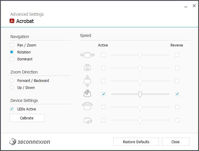

for the last 10 or more years I've been using my SpaceNavigator to zoom in and out of Adobe Acrobat pdf's. That stopped working so I downloaded the latest drivers. Still no luck. I see that the SpaceNavigator is no longer supported so I purchased a SpaceMouse Wireless. That gave me the same results. What's happening? What changed? It's frustrating to say the least.
Here is a screenshot showing the only configuration that I have found. It only works on a multi sheet .pdf to navigate through the sheets.

How about ticking the "Pan/Zoom"?

I'm sure it was working a couple of days ago at work, Windows 10, but I have just tried it at home, Windows 11, and I can't zoom in or out or scroll left and right. It only scrolls the page up and down. I don't remember if the previous drivers worked with Windows 11.
I tried importing my 3D connections settings from my work PC, saved about 10 days ago, and that stopped any movement in AA. Restoring the default settings takes it back to scrolling up and down only.
I was going to post my settings but they are now the same as yours!
I'll look again at work next week to check it is still working but I don't think there have been any updates in the last couple of days.
Clicking pan/zoom doesn't help

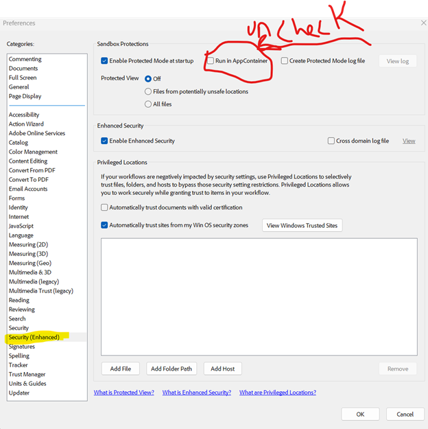

this is the only way to get full functionality in acrobat, uncheck this box in settings and restart acrobat

This is perfect. MANY, MANY thanks!

Can't figure out how to edit my previous post, so I'll add that the solution @andrewl313 gave worked for me in Windows 10 (64bit) with 3DxWare 10.8.21.3755

Since Adobe updated their software to the version with their AI garbage, nothing works for me anymore, even with the appcontainer thing I mentioned before. My next option is to try and install the 32bit version
