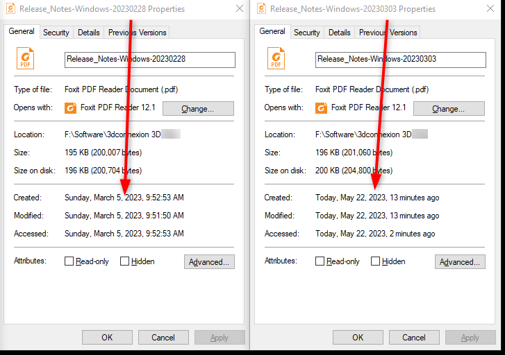

A clarification on my previous reply regarding the 3DxWare SketchUp version support after getting a private message from 3Dconnexion company's Mr. Amro that the current v10.8.12 do supports SketchUp 2023, I downloaded the latest Release_Notes-Windows-20230303.PDF driver release notes and confirmed as below:
