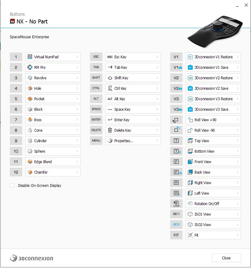

Hi,
I have been using a SpaceMouse Enterprise for about a year in SolidWorks but have recently switched jobs where I now use Siemens NX. I have been able to get the pan/zoom/rotate functions to work in NX, but I cannot seem to get the buttons customized to my liking. When I enter the button customization window in 3D Connexion either through NX or 3D Connexion itself I am not given an NX tab to select functions for customization. Any ways to fix this? I have already contacted IT and searched Google for hours. Here is a visual for reference:
3D Connexion NX-NoPart.JPG (95.46 KiB) Viewed 5078 times

What's the specific NX release you use in your work? E.g. NX1847, NX2206.
The latest 3DxWare v10.8.12 supports only the initial major milestone releases, e.g. NX1847, NX1872, NX1899, NX1926, NX1953, NX1980, NX2007, NX2206, NX2212. Any succeeding minor bugfix/maintenance release between two adjacent major milestone releases is not supported,
e.g. NX1851, NX1855, NX1859, NX1863, NX1867 are not supported(they are between NX1847 and NX1872 milestone releases).
