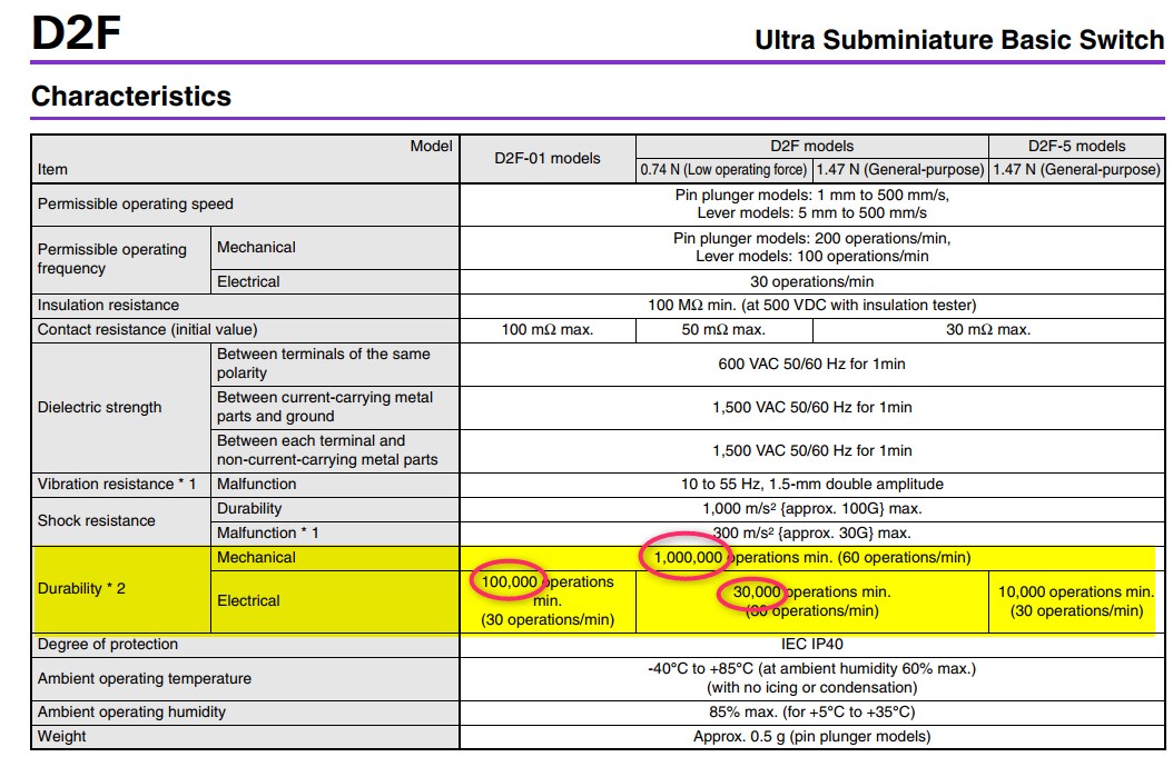

This is how constant the 3DxService.exe and 3DxProfileServer.exe are monitoring and changing profile/configuration files. By the way, the microswitches used by the two side buttons of your 3Dconnexion CadMouse are of low lifespan(durability), about 5 million mechanical clicks per side button microswitch, actual electrical durability is even shorter(less than 5% of the mechanical durability) when electricity is on.
luping
Posts: 1114
Re: CAD Mouse button macros sometimes not working
Post by luping »
OMRON microswitch.jpg (190.47 KiB) Viewed 12168 times
The three main buttons in CadMouse Pro Wireless, CadMouse Pro use OMRON blue dot D2FC-F-K(50M), with 50 million mechanical clicks durability, but it will cause double-click issue after roughly 8-12 months of intense use in office before you apply for replacement through RMA.
