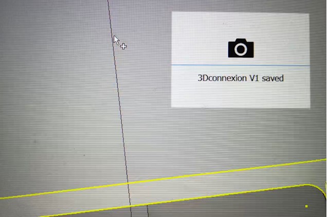

My enterprise keeps automatically saving and resetting the view.
I dont have to be touching the space mouse for it to happen, its just started this morning its been working great for many years until now.
