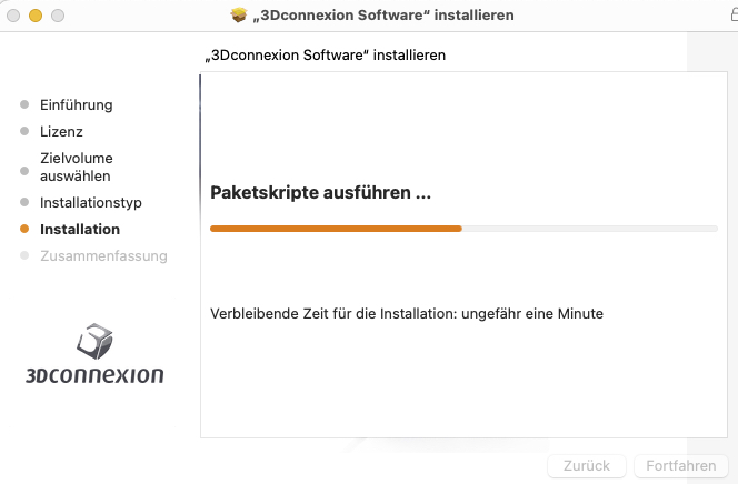

I have Sonoma 14.1 now and just can say that the new driver installation
stalls for me after half of component registration.
Tried it 2 times with a reboot in between.

I finally got it installed.
Not sure what really helped ..... but,
I deleted and manually re-added all 3D connection settings from Apple Settings / Privacy
and started the Settings /3DConnection driver settings.
At one point I was finally asked again to allow another one of the 3DCon Apps privacy
settings and driver settings showed 10.8.2 now.
Also the driver installer dialog had finished successfully at this point and I had to reboot again.

I have installed Sonoma 14.0;
The workaround to update to the 3DxWare 10.8.2 driver is to manually force quit 3Dconnexion Helper from Activity Monitor

Post by fpsnyder »
Having experienced this same 10.8.2 driver install on Sonoma, I then tried a different approach that worked. Run the uninstall program from the 3D Connexion folder first, restart, then install the 10.8.2 driver. This method appears to get around the install hanging up on the "Running package scripts..." and not seeing the SpaceMouse or CADMouse in properties. Hope this helps!
