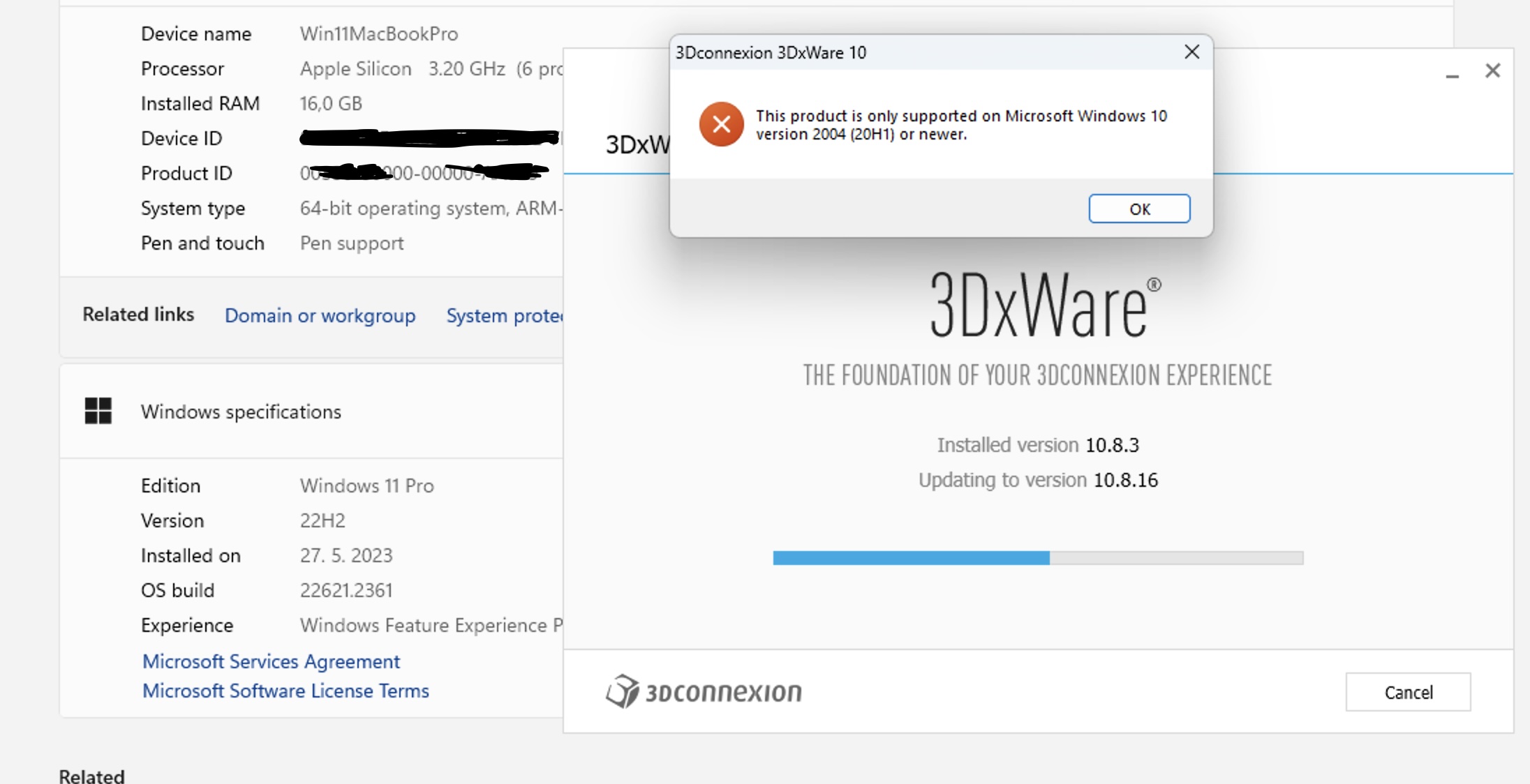

I am using for Space mouse drivers version 10.8.3 on Window11 pro ARM 22H2 virtualized via Parallels desktop on MacBook Pro M2max. It works fine.
However newer version 10.8.16 incorrectly identifies Windows version and does't install.

PeterARM
Posts: 8
Joined: Sun Oct 08, 2023 12:07 am
Re: Windows 11 ARM driver
Post by PeterARM »
Image to show you.

PeterARM wrote: ↑Sun Oct 08, 2023 12:11 am However newer version 10.8.16 incorrectly identifies Windows version and does't install.
The driver included in v. 10.8.15 of 3DxWare 10 (and newer) requires a system call that was introduced in Windows 10 version 2004. It looks like the check is invalid in Windows 11 for Arm or the required function is missing (unlikely).
Currently, 3Dconnexion does not officially support Windows 11 on Arm.
