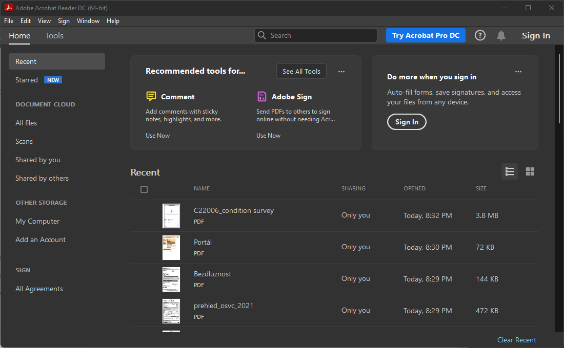

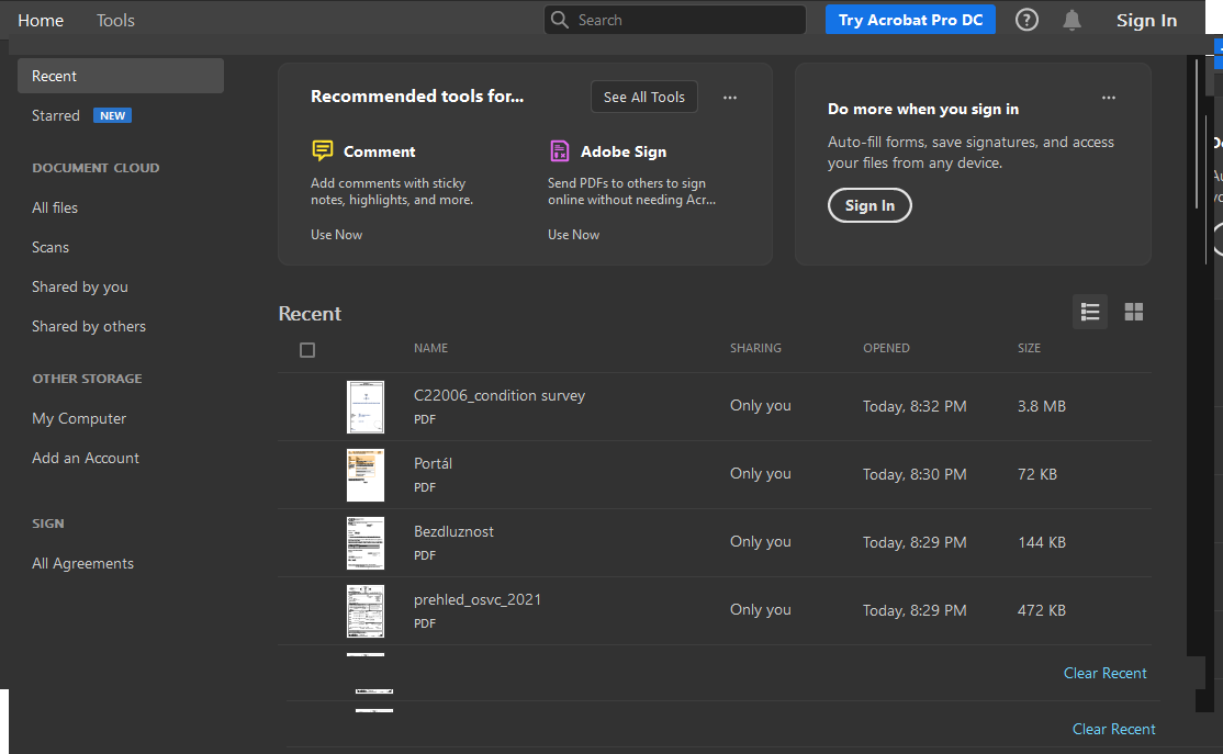

I have a problem between 3DxService.exe and adobe acrobat reader (AAR). If I move the mouse pointer over the menu bar in AAR, it will strangely disappear and the whole graphic will be damaged Reader. It goes wrong again each time you hover the mouse.
The problem occurred after installing the drivers for your cad mouse product. I tried to end task the individual processes in the task manager, and I found out that the whole thing is done by the 3Dconnexion.exe application. The whole thing is very annoying, and it significantly worsens the work in the AAR.
I tried uninstalling and reinstalling both, your drivers and ARR, and nothing helped. The problem still persists.
What could be the problem? Can you think of a solution? Any idea?
