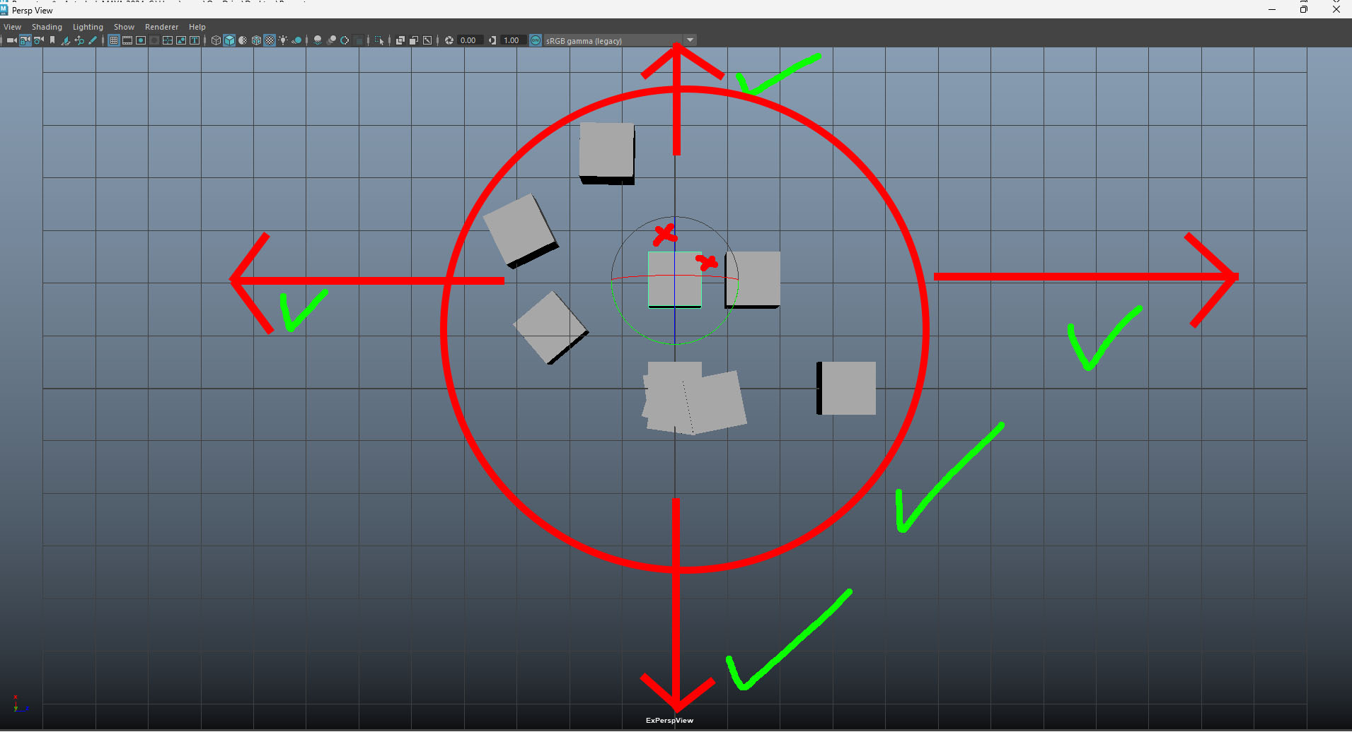

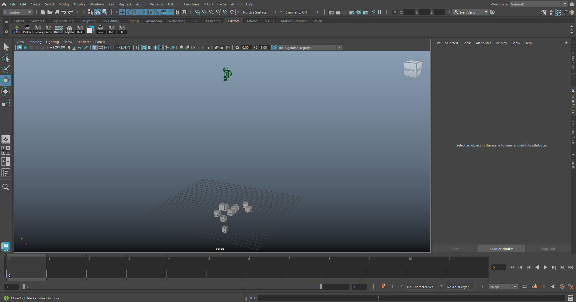

So this is my setup: (Example1) A camera is facing downwards onto some cubes that I want to manipulate.
It is NOT the orthogonal Top-camera, but a normal perspective camera that I have put above the cubes at some distance and locked at a 90 degree angle.
I am using a tear-off copy of this view to manipulate my objects. (See Example2)
Now the thing is: This way I can manipulate the objects along the world axis. Basically the objects always move and rotate in relation to the active camera. This means that I have no way to actually rotate the object around its actual local axis except using this fixed perspective which lets me at least use "rotateY" since this is basically the camera roll-axis.
In a nutshell, of the 6 possible axis, I am able to "use" 4 properly, I can move the boxes right, left, up, down, forwards, backwards, just because they are perfectly aligned with this camera. (Orthogonal cameras actually only allow for movement, so I have to use perspective cameras to unlock rotation at all)
The big issue is this: I am never really manipulating the Object's axis truly. I am always manipulating the object in relation to the camera I am looking through. This means, if I have my camera perfectly aligned as I did in my scene, the Object's axis at least coincide with the world axis that I can use (and also rotateY) which is just a roll movement if you look at it from above (Up axis is Y in Maya)
It is a workaround that lets me lose 2 axis (RotateX and RotateZ in this case) because if I rotate around the Z axis by 90 degrees, it "becomes" the local X axis.
(It shows really well in that example since once you rotate the cube by 90 degrees, it looks just like 0 degrees - basically no indicator that actually the axis have switched)
The main idea is still to get my Mouse input axis clean onto the local axis (or world, I dont care, but just NOT in relation to the camera I am looking through) of my selected object.
I hope the images make my point more clear...

Thank you, yes, that is correct. I can use the object mode to move and rotate objects in Maya.
I just don't understand that this is not a normal setting with this mouse. In my opinion it is really weird to add the option to rotate objects,
but entertain the idea that you don't want to just "look" at things but also actually use the Mouse to properly manipulate them.
Happy second Advent by the way!
