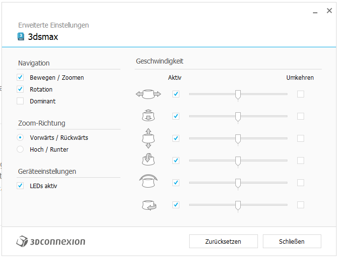

i have a SpaceMouse Enterprise and i try to use it with 3ds Max 2024 from Autodesk.
In Inventor it works perfectly but i can not move in the 3D environment of 3ds Max with my SpaceMouse.
Can someone please help me?
I turned on all Options for Zoom and Rotation and i added a screenshot of my settings

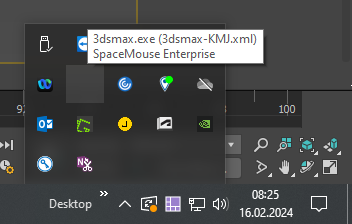

Can you share what do you see when you hover over the 3Dconnexion driver in the system tray icon when you are focused on the 3DsMax?
Also do you open specific file or option/environement in the 3ds Max?

shure. i added a screenshot.
No i dont open secific files or options. Everything is on standard and i fresh installed.

I see you have wrong xml file loaded. It should be 3DsMax.xml not 3dsmax-KMJ.xml
Which 3Dconnexion driver version do you use? If not 10.8.17 please download it and update.
If you use newest 3Dconnexion driver. Please try this steps https://3dconnexion.com/uk/support/faq ... on-windows/ from our FAQ.
Also if you don't want to lose your driver configruation you can export them using main driver panel: More > Export Settings“.
