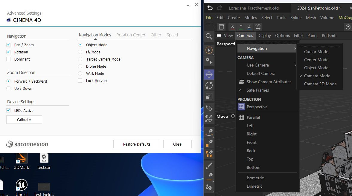

1. 3Dx Drivers Navigation Mode is set as Object Mode but the problem persists in every setting.
2. Cinema 4D has his Navigation Mode panel but SpaceMouse follows only his Navigation Mode sets on 3dx drivers and ignore Cinema4D nav-mode.
So ... in my videos I've tried a smooth movements but it's very laggy and intermittent ... and I confirm that the CoR change everytime.
