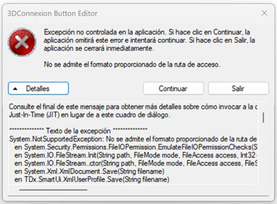

We have a similar problem that we need to solve. We develop software with Embarcadero C++ Builder and we have integrated 3Dconnexion SpaceMouse using the Siapp API.
For some time now it is not possible to configure the buttons. When trying, 3DConnections settings fails showing the error like the image attached.
We thought that updating the SDK could solve the problem, but we can see that version 4 does not include Siapp API. How could we get the latest version that includes Siapp API?
Thanks a lot
jwick
Posts: 3456
Location: USA
Re: How to find out using the COM interface whether the SpaceMouse is plugged in?
Post by jwick »
Hello,
This may not be an SDK problem. The "old" SDK hasn't changed in many years.
Can you please contact developer support? We'd like to see some files surrounding this error.
You probably need to join the Developer Program to access developer support page.
Thanks.
