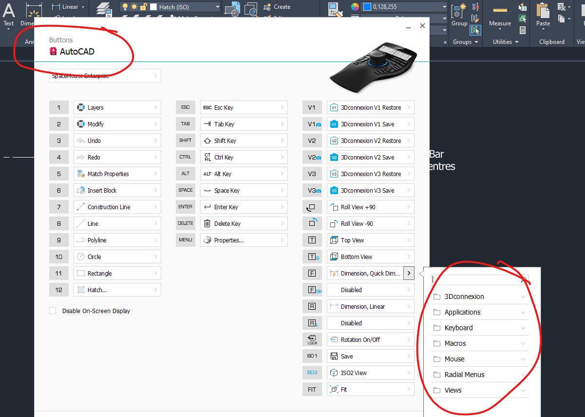

I upgraded my AutoCAD to AutoCAD 2025 today and my Spacemouse Enterprise is not working correctly with it.
I can move the drawing fine but the buttons don't do anything.
When I try to assign a new function to a button AutoCAD doesn't even show in the menu 50% of the time (see attached image).
I have updated my driver etc but cant get it working properly.
Is AutoCAD 2025 supported?
Any advice appreciated.

Reinstall the latest v10.8.19, the plug-in for AutoCAD 2025 is included back to September last year.

I have tried that but unfortunately it hasn't helped.

johnb440 wrote: ↑Tue Apr 02, 2024 2:27 am I have tried that but unfortunately it hasn't helped.
Well, downgrade the AutoCAD to a previous version, or wait for an updated version of the 3DxWare driver.
If the button mapping is what you really need in SapceMouse to get your work done, go with a compatible version of AutoCAD.

luping wrote: ↑Thu Mar 28, 2024 8:54 pm Reinstall the latest v10.8.19, the plug-in for AutoCAD 2025 is included back to September last year.
That's correct but it looks like a later ObjectARX SDK update broke the add-in.
Version 10.8.20 of 3DxWare 10 has support for AutoCAD 2025 RTM.
