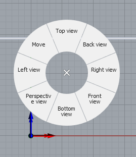

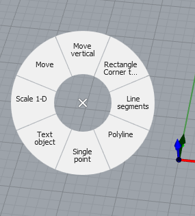

I am using a wired Cadmouse compact in Rhino. At work we have floating licenses for Rhino6, Rhino7 and Rhino8. I was mostly using Rhino6 because I do the CAM and our RhinoCAM version was for Rhino6. I had noticed that there were some bugs where the radial menu didn't work correctly when switching between versions and would break, but it mostly worked ok in Rhino6 and Rhino7. But not we are upgrading RhinoCAM and moving entirely to Rhino8 and the radial menus do not show any icons.
I have a new computer set up with only Rhino8 installed. When I go to create radial menus, the icons are not present, only text. when I use the radial menus, the case is the same. It is severely disrupting my workflow. Does anyone out there have Rhino8 working properly with their Cadmouse, or is this an endemic issue across everyone?

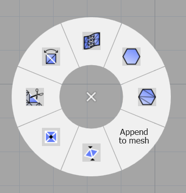

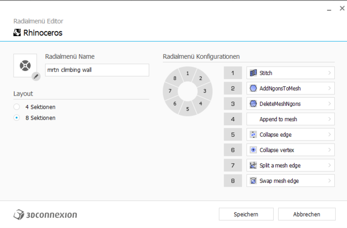

I heard back from someone in the Rhino forum that has icons working in Rhino8. He however is not able to make new ones or change them, but it was working at some point and radial menus he created a few months ago contain icons. Here are photos of his icons, and one where he isn't able to get an icon (Append to mesh). It previously had an icon. In any case, there is an issue that should be looked into.
