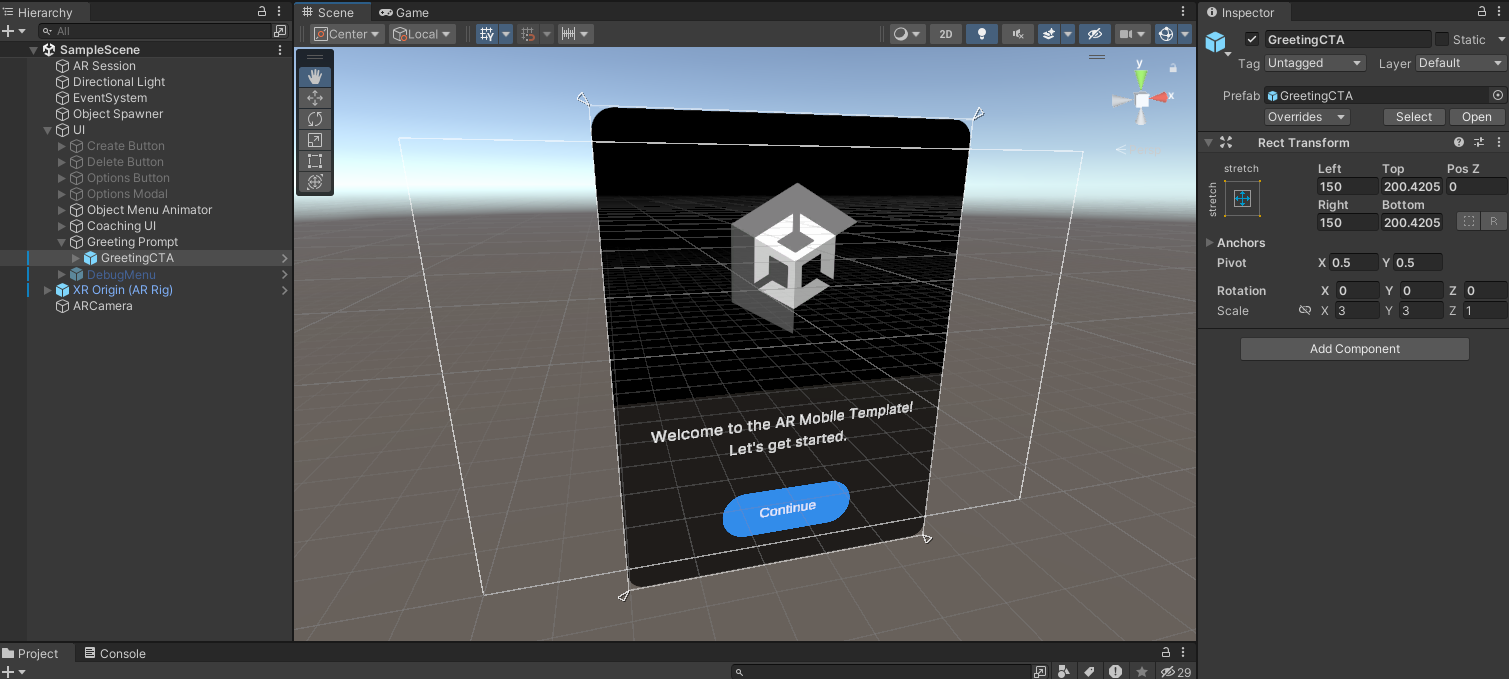

Hello all I am trying to find anyone who has functionality of their spacemouse in the Unity environment and being able to change your perspective of the camera with the mouse. i only get a zoom in and out function on first setup. Any help would be awesome!
Screenshot 2024-05-09 161516.png (220.03 KiB) Viewed 1675 times

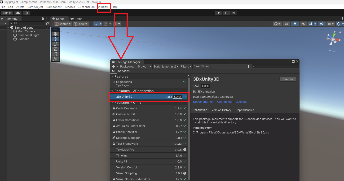

Hi WeCr8Fun
Thanks for post.
I would like to know which version of the 3Dconnexion driver are you using?
Also please check if you see 3Dconnexion tab on the menu bar in your Unity project.
If not please go to "Window" -> Package manager and check if you see 3DxUnity3D plugin in the manager
MicrosoftTeams-image (1).png (224.6 KiB) Viewed 1667 times
