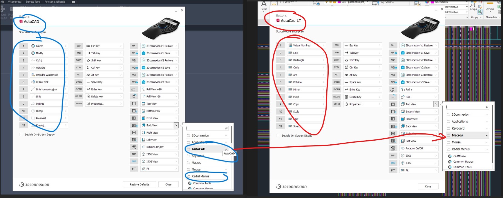

I don't speak English very well, so maybe I'll attach a picture and a summary.
How to export these settings with commands and icons and assign them to AutoCAD LT.

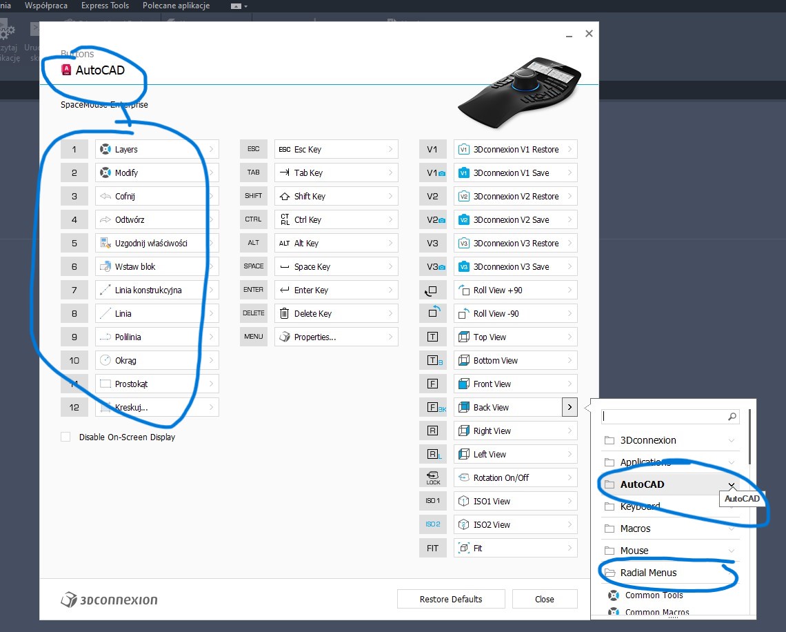

Re: SpaceMouse Enterprise - buttons AutoCAD
The image shows that I need to select a tab with AutoCAD commands.
Or how to make a macro with layers, enable, freeze, isolate, etc.
or assigning commands to a new macro?
AutoCAD LT is a scaled down build of AutoCAD proper.
3Dconnexion maintains an ObjectARX application (an AutoCAD plug-in) to export the application commands, allowing users to assign them to device buttons and in macros. Since AutoCAD LT does not support ObjectARX, the plug-in is not available in LT and users need to use more basic solution (like keyboard shortcuts).

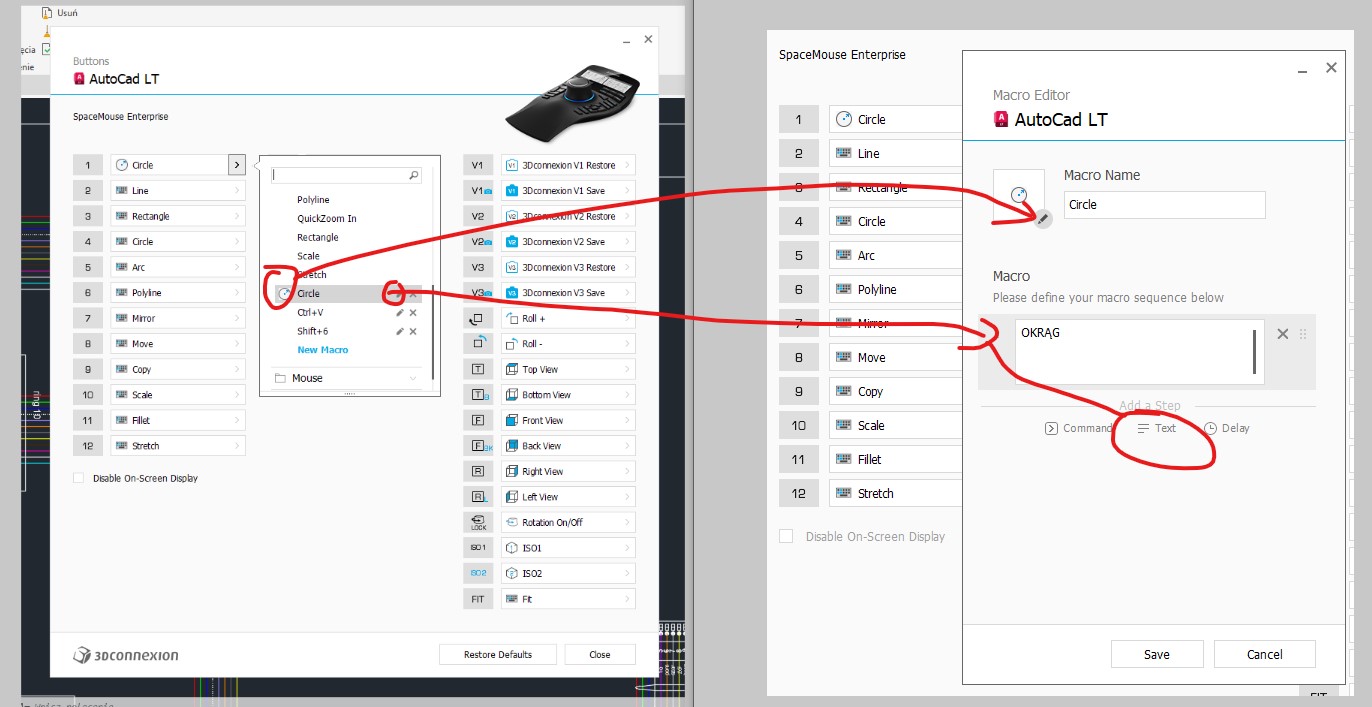

Defining keyboard shortcuts to most AutoCAD functions is very difficult or sometimes impossible.
I dealt with the topic in such a way that I check with what command the function is run and create a new macro and enter the command but as text. I draw my icon without a background and attach it as a 24 pixel image.
My solution requires a lot of work to describe all the functions I need from scratch, but should then allow you to enjoy using SpaceMaus at work.
I attach a picture with an example of how I made a button to create a circle. I will try to show how it looks when I do the whole thing.
Like I tried to explain, AutoCAD LT does not load AutoCAD plug-in (ObjectARX applications in Autodesk parlance).
We would very much like to have a plug-in solution for AutoCAD LT or -- better still -- having the application itself supporting the driver button programming feature.
