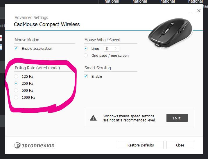

I lowered the polling rate from 1000hz to 250hz and that helped a lot.
