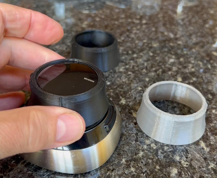

Spacemouse TPU 3D printed sleeve.jpg (73.12 KiB) Viewed 22810 times
Here's a picture of the 3D-printed one I've made...
