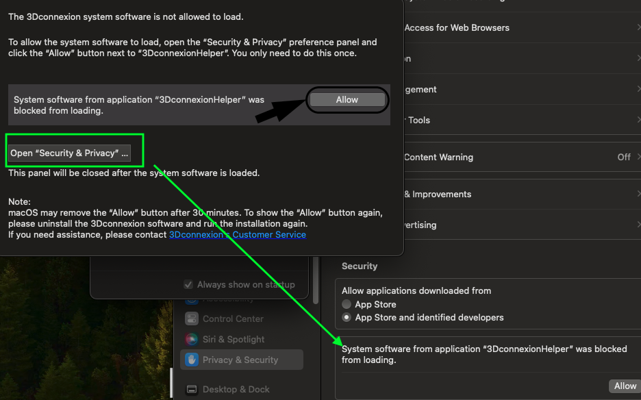

SpaceMouse Wireless
Re: Why is it so difficult to get the driver to work?
I use the same SpaceMouse wireless on my windows 11 computer and it is working normally without any issues. So it seems to be strictly a Mac OS software issue.
I've tried removing the software and reinstalling it multiple times. I've tried rolling back to the previous two versions of the software and I'm still having the same issues.
Your software pops up a message telling me that I need to modify something in the macOS security settings. It provides a link which takes me to the security section. But it never shows me the options that appear in the dialog screen. What's odd is, I have seen the security options in the past, but for whatever reason that no longer pops up when I click on your dialogue button to access the security settings.

Hi jgaltUSA
So when 3Dconnexion software pop-up telling that you need to modify something in the macOS security settings, you should click "Open: Security & Privacy ...". MacOs security & privacy setting tab will open. Please scroll a bit lower under, you should find there information about 3DconnexionHelper with "Allow" button.
- Attachments
- Untitled.png (240.05 KiB) Viewed 13091 times
Thanks. I'm doing that step. But that's the problem, it never goes to allow part the system preferences. And when I look for it manually, I can't find it anywhere.
