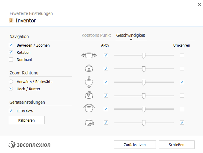

I use Inventor 2020 with Parallels Desktop running Win11 with a Space Mouse Compact assigned to the windows machine. (latest Driver 10.9.6.699)
I changed the Navigation Direction and had to flip 2 axis in the advanced Setting in the 3dConnexion app for Inventor.
Now the strange Problem: Sometimes or Always when I switch between models in inventor the 2 inverted axis just flip. Only way to come back to normal is to open a different windows app and switching back to Inventor.

That’s frustrating! I’ve had similar axis-flip issues with 3Dconnexion in Inventor too. Did you try locking the profile or creating a custom one just for Inventor?
