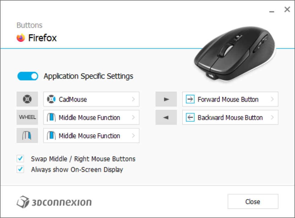

is there any way to make "swap middle / right mouse buttons" app specific? I already enabled the "Applications Specific Settings" but when I tick/untick "swap middle / right mouse buttons" it keeps changing for all the apps..

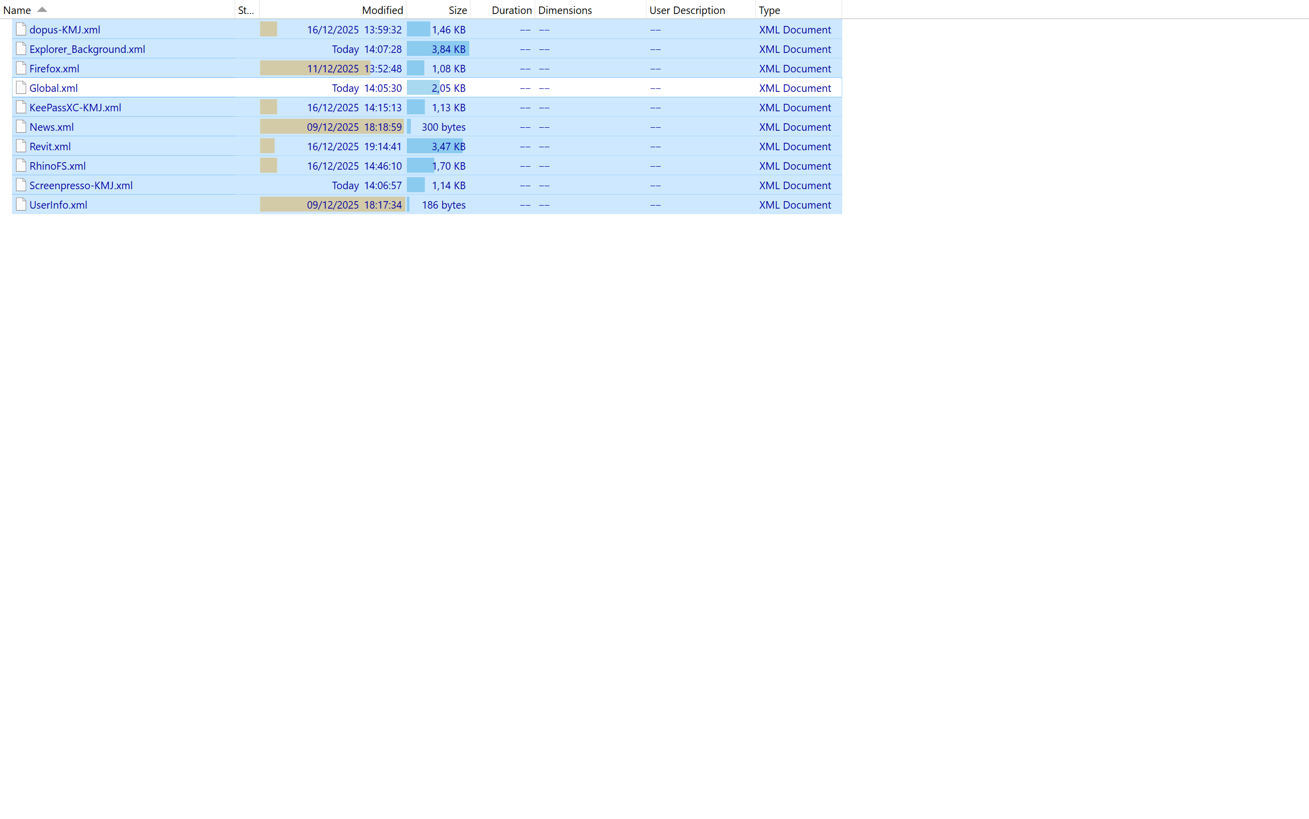

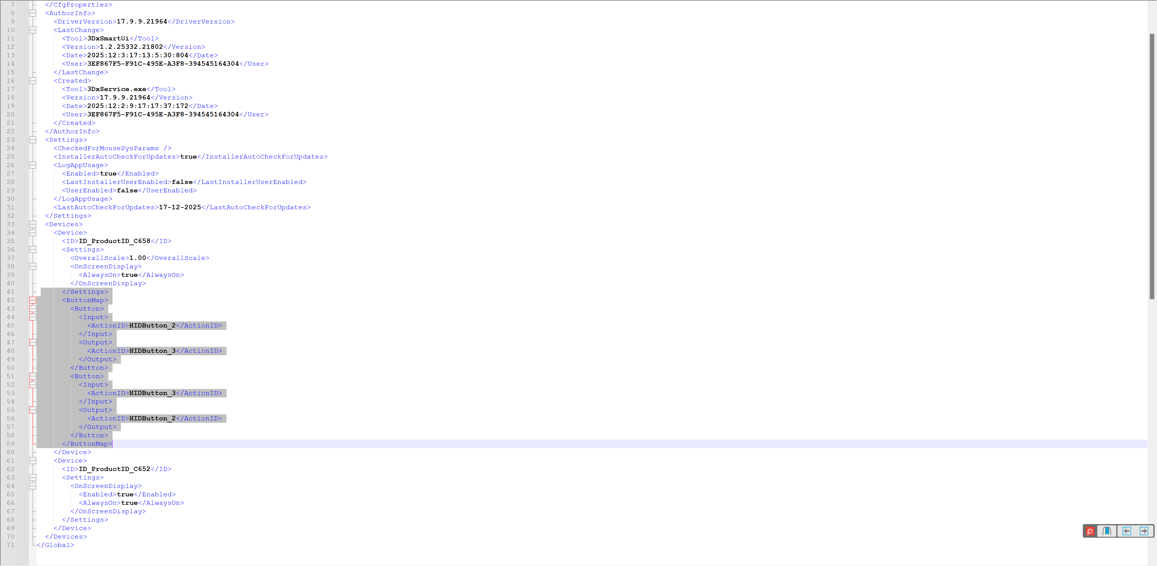

so I would have to enter the selected lines of the global.xml into the configs of all the other programs that I want to swap middle / right click? (As seen in the screenshots)

Sort of. Some of those are not AppCfg files. Only put it in files that start with <AppCfg>.
You will need to make the <Devices> container if it doesn't exist, and add the entire <Device>...</Device> section.
Take it out of Global.xml.
Also, there may be System Settings panel options that you need to return to normal (non-swapped) state.
