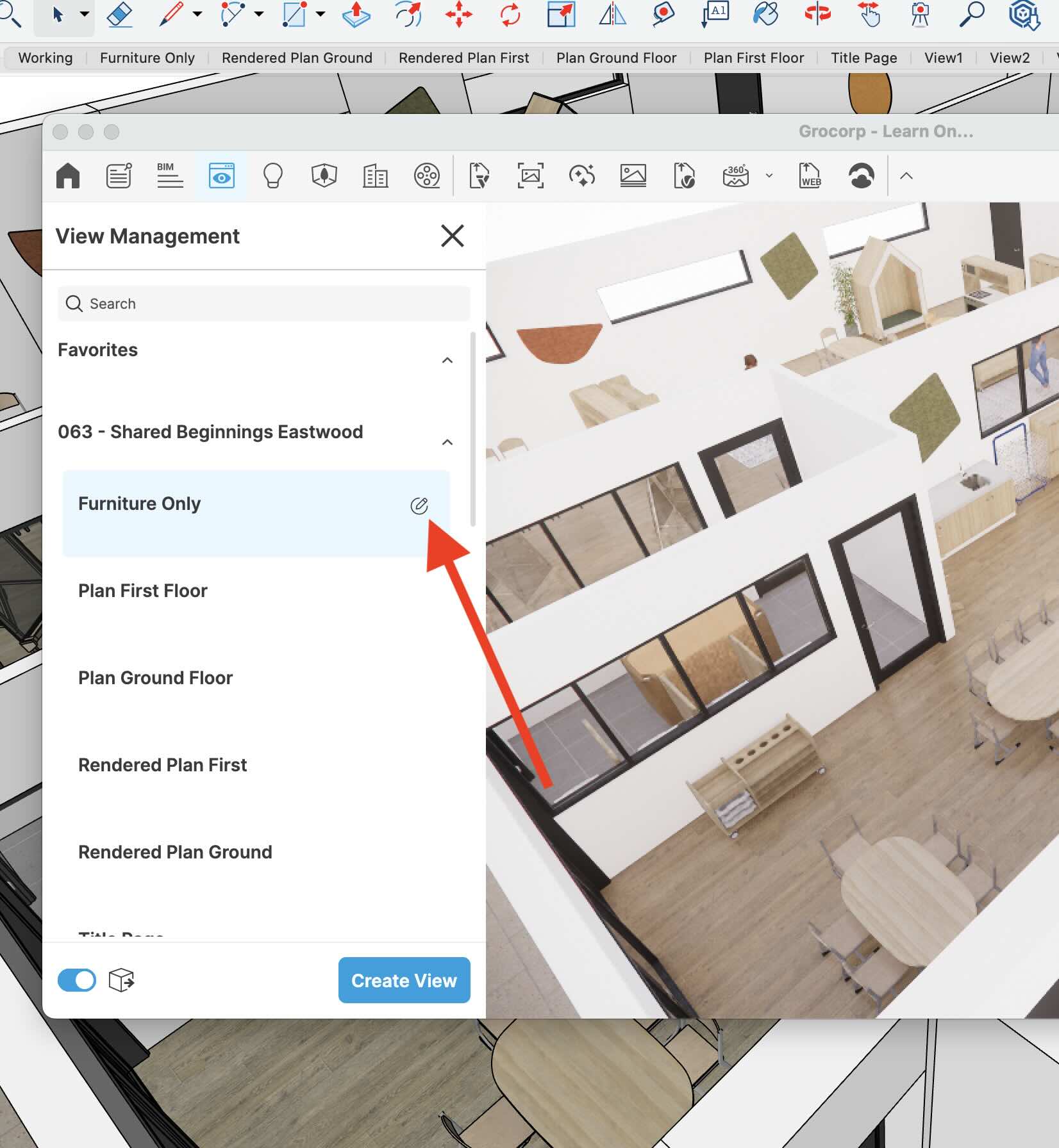

Screenshot 2026-06-26 at 8.58.48 am.jpg (167.95 KiB) Viewed 322 times
I have been discussing this issue with the Enscape software developers. There is a memory address conflict between Enscape and the 3d Space Mouse Driver which causes a crash in Sketchup. When you go to edit a scene within the View Management menu in Enscape, this action causes the conflict with the space mouse driver and results in the crash.
