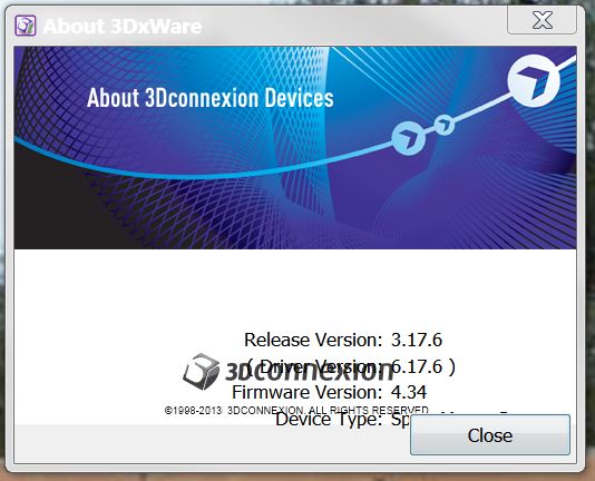

The other day I noticed if I did not have the spacemouse pro plugged in I could not crash Rhino with my mouse. I tried uninstalling the beta driver and reinstalling the latest driver release version 3.17.6 driver version 6.17.6 firmware 4.34 (also the text in the about box has a logo overlaying it making it difficult to read, see attachment).
So my question is the video card screwed up or is the spacemouse pro driver causing Rhino to crash? Is there a log I can look at that may indicate if there is a problem?

- 3d.JPG (45.76 KiB) Viewed 4615 times
Re: Rhino Crashes
Hi dfurlano,
you can try the log of the driver, but I would say as Rhino is the one who crashes we need a log from Rhino. Unfortunately I don't know where you find it and how ot activate the logging if necessary. I can only tell you that you can activate the logging of the driver in the 3Dconnexion properties in the menu "Tools". Activate the entry "Write Log File". The log file is written in the folder %APPDATA%\3Dconnexion\3DxWare. The name is 3DxWare.log and the driver always overwrites it if it starts.
