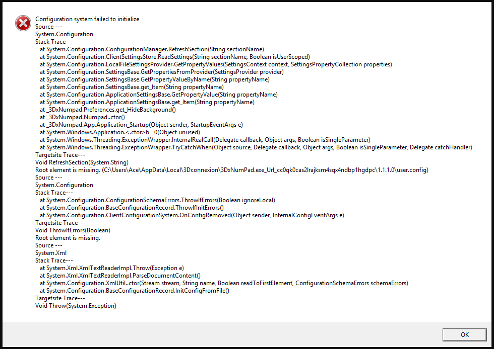

Help.
Everytime I start up the 3DxWare64, I get these 2 errors.
I've tried uninstalling and reinstalling the latest drivers, still to no avail.

Hello smakkyoface -
The 3DxNumPad Unhandled Exception error is caused by data corruption in the "user.config" file of 3DxNumPad.exe.
To correct the problem, stop the driver then delete the folder [ or folders] inside the 3DxNumPad folder that contains the "user.config" files. [Start, All Programs, 3Dconnexion, Driver, Start Driver - Stop Driver]
The folder is located at: "C:\Users\<user name>\AppData\Local\3Dconnexion\3DxNumPad.exe_Url..."
Restart the driver and a new "user.config" file will be created.

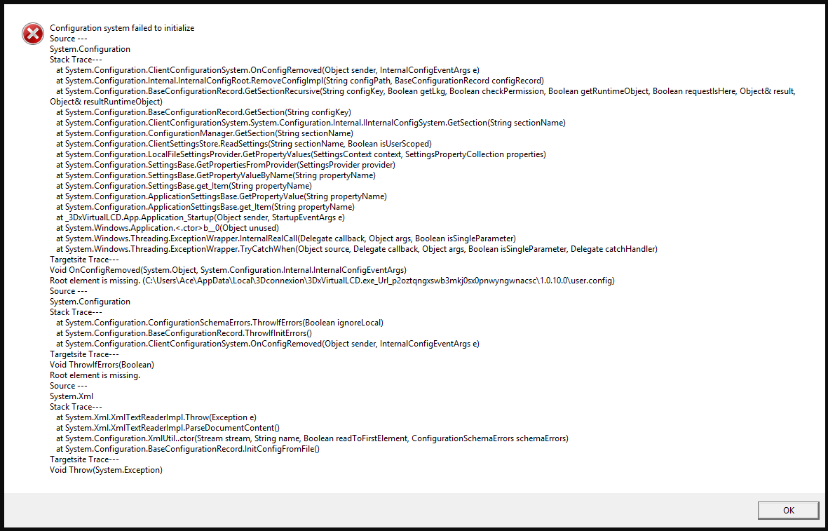

I get the same messages. When I follow your instructions to correct the problem, [Start, All Programs, 3Dconnexion, Driver, Start Driver - Stop Driver] I get to 3DConnection, but no Driver start or Driver stop. Any suggestions? I am running Windows 7.

I am using the Beta 3DxWare64SPP_v10-0-16_r1544.exe Software and I get the 3DxVirtualLCD Unhandled Exception error.

C:\Users\<user name>\AppData\Local\3Dconnexion\3DxVirtualLCD.exe...
Open the folder3dxvirtual folder
Open the 1.0.10.0 file
Delete the user.config
Close then restart the computer (Since your running the Beta, the driver launches differently than the 3.7.16 driver.)
If this doesnt work you'l have to wait for a programmer to respond they handle the Beta driver.
