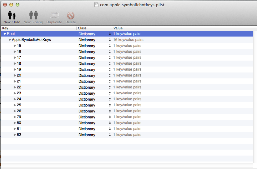

thnaks for the info. i did all the instructions but i have no numbers 55 and 56?
see attachment.
when i use rotate in cs6 it does some random zooms and then crashes? any thoughts...
