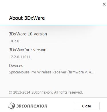

That's great! Are you referring to version of 3DxWinCore? I'm currently at version 17.1.2.10488 (see attached screen capture). How do I update to version 17.2?
Version Screen Capture

JWICK - Just downloaded latest 3DWare 10.2 driver which includes 3DxWinCore version 17.2 but it did not fix the problem. How do I get this problem resolved? I'm disappointed this $350 mouse has been sitting useless for over 3 months.
