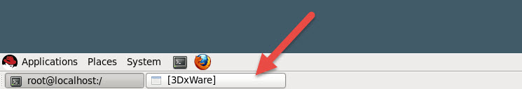

If the driver is started the 3Dconnexion panel is started automatically. It might be minimized. If you do not see it the driver is not running.

How did you test the device? You mentioned "it is working like a charm".
Check all available windows and buttons on your panel (like the Windows taskbar).
3DxWare window minimized.jpg (15.17 KiB) Viewed 60475 times
