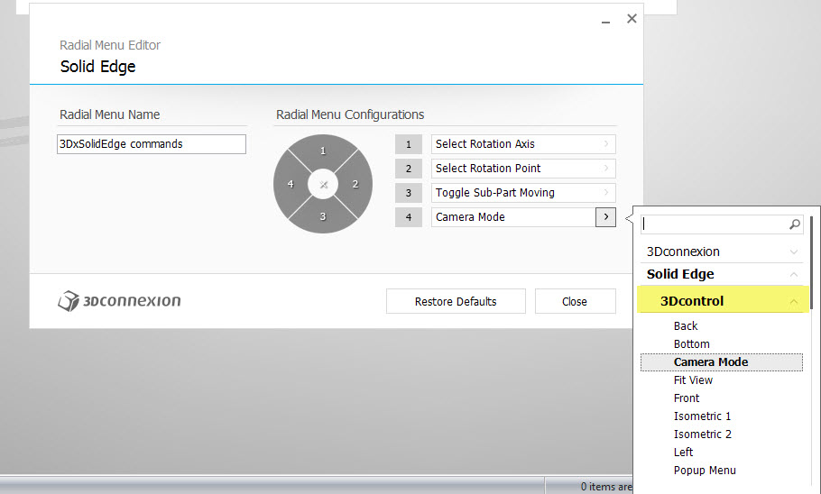

Hello underground3d,
with 3DxWare 10 the toolbar in Solid Edge for the3Dconnexion doesn't exist anymore. You can map these functions to the buttons of your 3D mouse or create a Radial Menu with the commands that you need. See my example:
Note that you have different button mapping for each environment. You will find the commands in the sections "Solid Edge -> 3Dcontrol". And with 3DxWare 10.2.0 you even do not have to click to the section of the Radial Menu; you can just move the mouse cursor over that section and you will see it highlighted and after you left it the command will be started.
