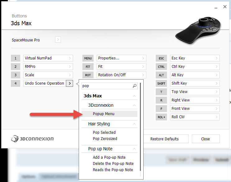

You can pause the input in the 3Dconnexion properties in the Advanced Settings -> Other Options. Enable the option "Pause motion". (This is described in our documentation.)
There is as well a command “Popup Menu” from the 3ds Max ->3Dconnexion category that you can map to a device button and pause motion from the popup menu that appears when you press that button.
Map Popup Menu to a button.
Map Popup Menu.png (66.48 KiB) Viewed 3803 times
Pausing motion cannot be done automatically.
