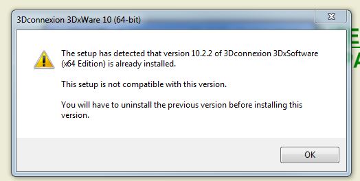

Re: SpacePilot Pro and Logitech LCD Manager
i have tried that, i attached the message i get when i try to download the driver.

Hello khornocker -
A 'Please insert Disk 1 ...' error means there is 3Dconnexion software installed on your PC that is no longer linked to its uninstall information.
To remove it use the steps here . Since Windows cannot complete the uninstall, begin with the second part of Step #2 - the manual removal the 3Dconnexion folder in C:\Program Files. Check both C:\Program Files and C:\Program Files [x86] on a 64-bit OS and remove the 3Dconnexion folders. Delete C:\Program Files \Logitech\Game Panel Software to remove the Logitech LCD Manager folder.

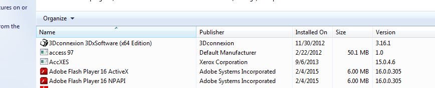

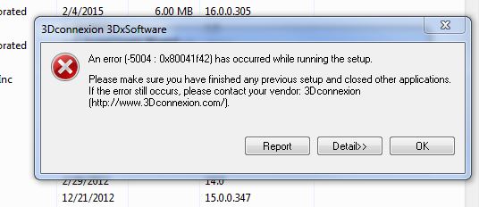

so I went through the step by step instructions again and im still having issues. once I was done deleting everything I went into the add/remove page and saw the first attached image. then when I try to remove the old driver I get the second image.
Hello khornocker -
The 5004 error happens when the installer does not find sufficient privileges to install the software.
The 3Dconnexion software needs to be installed installed from a profile with full administrator privileges.
If this is a networked PC and you do not have full permissions, an IT person needs to do the installation. If it is a home PC, you need to log in from an administrator profile to run the installation.
