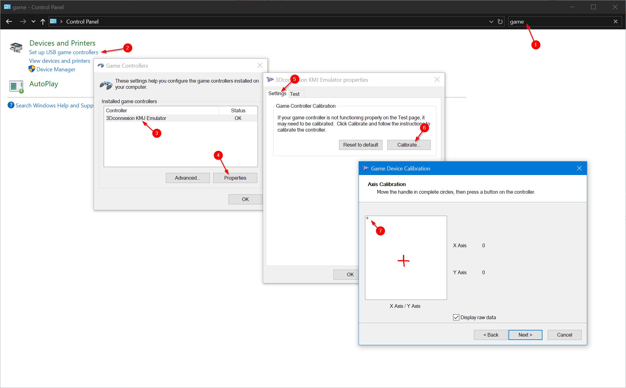

Hi!
I do not understand why this problem is ignored / not fixed by 3Dconnexion for 10 years!!!
If you open the USB game controller calibration for the 3Dconnexion KMJ Emulator in Windows Control Panel (attached screenshot) you will see that the calibration target (the little + symbol) stays on the top left corner of the calibration area. This calibration target should be in the center of the calibration area. Calibration does not work at all, because the target does not move if you push the SpaceMouse.
And because of this failure to calibrate the 3Dconnexion KMJ Emulator, the emulated joystick is constantly sending top/left input data to windows.
And many game engines (e.g. Unity) by default use all connected joysticks for user input, and so constantly get wrong input data from the 3Dconnexion KMJ Emulator.
What is the reason for ignoring / not fixing this problem?
thx
thx
