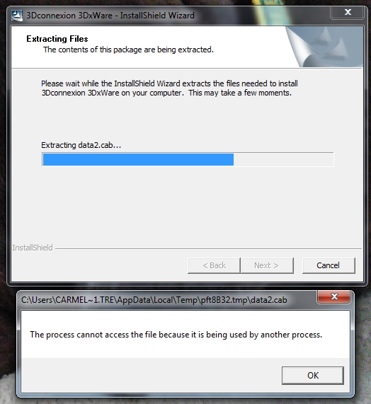

Went to re-install the 3DConnexion software and boom....the best message a person can get "The Process cannot access the file because it is being used by another process" screen pops up.
Last time I saw this with SW a few versions ago I just blew by all the prompts and I was golden. Did the same again with this version and boom...nothing. Doesn't work. This time after cleaning everything up still doesn't work. Personally I think a great product is being hampered by the software used to run it, but that's for another thread.

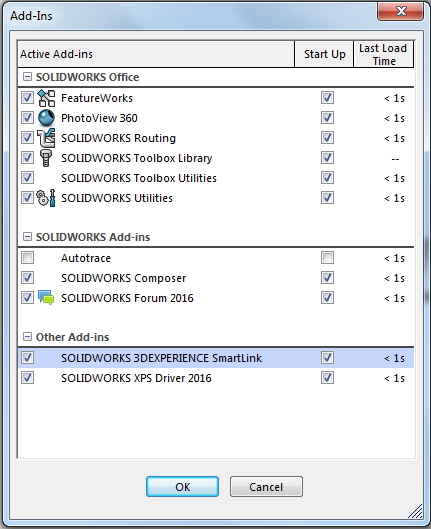

Do you see the addin in SolidWorks? See "Tools -> Add-ins... -> Other Add-ins. You should have an entry "3Dcontrol". Can you see it?

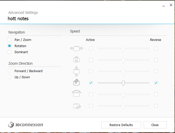

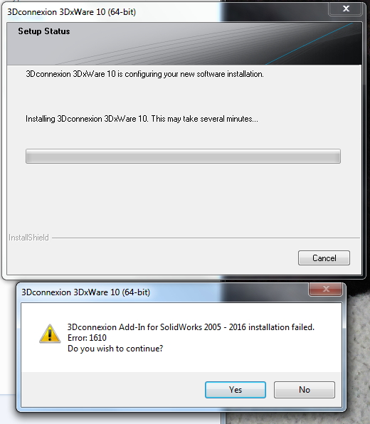

Re: SpacePilot Pro and SolidWorks 2016 - She No Work!
Here are some graphics
another

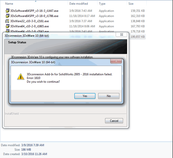

- Attachments
- 20160310002.jpg (123.76 KiB) Viewed 22552 times

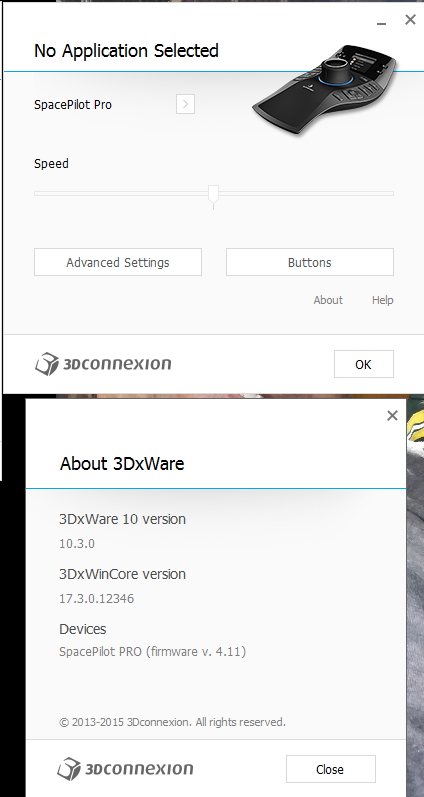

Here's the software data
- Attachments
- 20160310003.jpg (108.29 KiB) Viewed 22551 times
Ok. So you still have problems to install the driver and the plugin.
Which version of the 3Dconnexion driver have you had installed previously?
If you still have the installation package please first install the version that had been installed before and then uninstall it. If this works well you can try to install the latest version. Which is 3DxWare 10.3.0 and can be downloaded here.

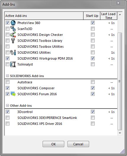

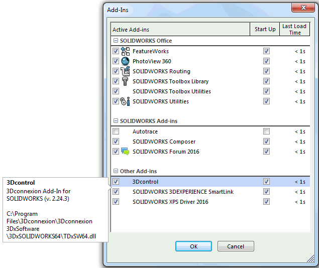

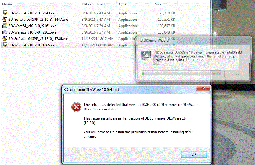

These are other two. I had 10.2 installed when 2015 was working.
- Attachments
- 20160310005.jpg (90.52 KiB) Viewed 22549 times
- 20160310004.jpg (135.87 KiB) Viewed 22549 times
had to make file smaller
- Attachments
- 20160310005.gif (129.61 KiB) Viewed 22549 times
So, after installing version 3.18 (no issues) I launched solidworks and of course it did not work. The training application worked just fine within the software. I think this version only works up to SW2014.
I then took your suggestion and uninstalled it and did an install of version 10.3. All went fine except for the error below (see picture). 3D control no longer visible under add-ins and of course unit does not work.

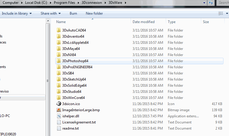

missing solidworks folder. Can you email me this folder and its contents?
- Attachments
- 20160311001.gif (29.31 KiB) Viewed 22535 times
