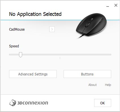

The problem I am having is that neither one is being recognized by SU 2016 Pro. If I have Outlook open and SU 2016 open, the settings window recognizes Outlook, not SU. If I have Firefox open, it recognizes Firefox, not SU. If I close all programs except SU 2016, the settings window says "No application selected" (see attached image).

With all programs closed except SU 2016
No Application.JPG (23.38 KiB) Viewed 4323 times

I checked the extensions window in SketchUp System Preferences and the 3DxSketchUp extension was unchecked.
