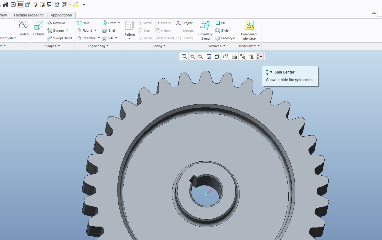

I managed to find the "spin center" and once activated everything worked perfectly. I now know what i was doing wrong. First when i was opening a part i was rotating it with my mouse clicking somewhere outside the perimeter of the model without the "spin center" command activated and this was setting my spin center way outside the zone of interest and after that if i used my 3D Space Explorer it was rotating my part like crazy.
But now thanks to you i know. I really appreciate you help. I will make my work way easier.
I've uploaded a photo so others in my situation can find the answer.
Thank you for you fast and very comprehensive reply.
