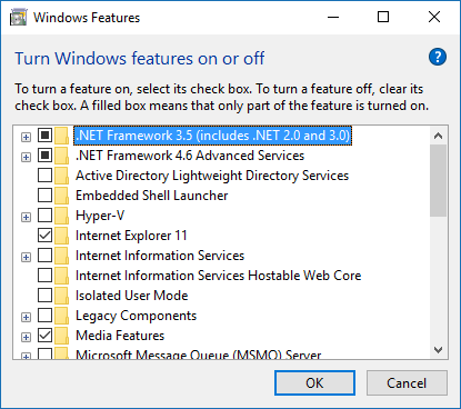

When I try to install the 10.3.0 driver, it poops out on me and gives me the infamous "1001 Error". Now I have dug around the forums looking for information about the 1001 Error, and found a lot of stuff, but it is all old and very pre-Windows 10. If I were better at Windows I might be able to figure out what to do from that old stuff, but I'm afraid that this is not my domain of expertise.
Other threads tell me to do all kinds of wierd stuff, like disabling .NET framework and then rebooting and then enabling it again, etc. But they all specify .Net Framework 4.5. I have the following options:
* .NET Framework 3.5 (includes .NET 2.0 and 3.0)
* .NET Framework 4.6 Advanced Services
I am not sure if "Advanced Services" is the same as ".NET Framework 4.6", or something different. Should I be toggling that off and rebooting and back on and rebooting again? Or is there something that I need to just install, or am I just totally on the wrong track?
Can someone help?
Thanks in advance.

- Attachments
- This is my "Windows Features" dialog
- Turn WIndows features on or off.png (15.52 KiB) Viewed 11488 times

Dear all,
I should add that, in at least trying to follow some instructions from another thread on 1001 errors, I did try to use "Turn Windows features on or off" to disable the thing called ".NET Framework 4.6 Advanced Services", reboot, re-enable it, reboot again, and try the install again. I got the same result.
Also, just a curiosity, but the installer then says that the installer failed and then asks me if I want to continue. If I say yes, it then proceeds to uninstall whatever things it half installed. This seems reasonable, but why would it even ask? Do I want a half finished installation of something on my machine, or am I misunderstanding this dialog?
