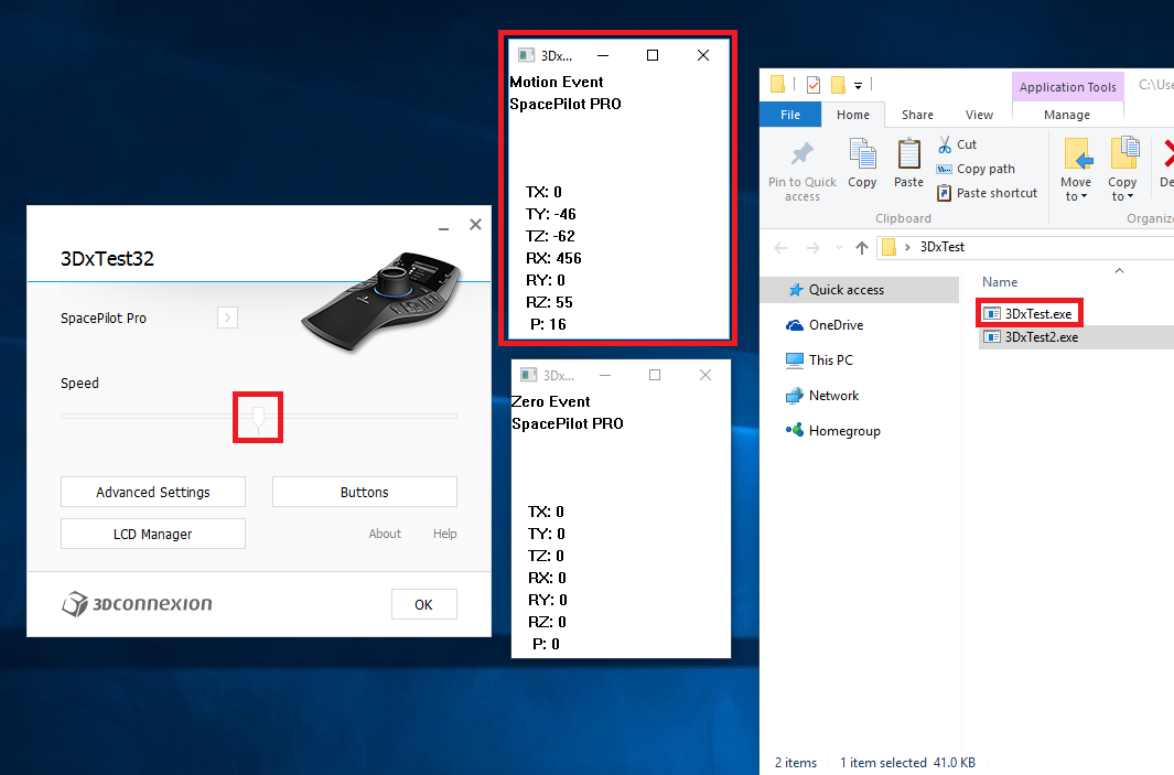

I reduces the problem as follows:
- compile the 3DxTest App -> 3DxTest.exe
- Copy the executable giving it another name, like ->3DxTest2.exe
Those two will behave differently in terms of:
- 3DxTest.exe:
- "APPLICATION USE" will be displayed in the SpaceMouse display when pushing buttons
- The Driver GUI's speed settings are grayed out
- Maximum Value for axes elongation is around ~500
- 3DxTest2.exe:
- "APPLICATION USE" will be NOT displayed in the SpaceMouse display when pushing buttons
- The Driver GUI's speed settings are functional
- Maximum Value for axes elongation depends on speed setting
See attached Screenshots:
What is this behavior and how can I control it?

If you don't have a cfg file for your application, the driver uses one that has the values scaled by 4:
Code: Select all
  <Settings>
    <ResponseCurve>1.7</ResponseCurve>
    <ScaleX>4.00</ScaleX>
    <ScaleY>4.00</ScaleY>
    <ScaleZ>4.00</ScaleZ>
    <ScaleRx>4.00</ScaleRx>
    <ScaleRy>4.00</ScaleRy>
    <ScaleRz>4.00</ScaleRz>
  </Settings>
3DxTest has a cfg file that does not scale the data.
Make a copy of the 3DxTest.xml file for your application (change the name ane ExecutableName) and save it into %PROGRAMDATA%\3Dconnexion\3DxWare\Cfg and it will get used when your executable is in focus.
Edit: I forgot to add that you can not rely upon the values from the device because users can always scale them. Program for +/- 350-ish and let your users make personal changes as they need to.
