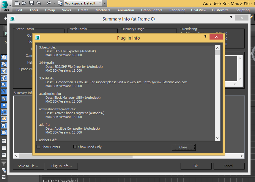

vinigor wrote: In 3DsMax plug-in manager there was no 3DXSTD.DLU, so I copied it from \Program Files\3Dconnexion\3DxWare\3DxStudio64\Contents\win64\ to \Program Files\Autodesk\3ds Max 2016\plugins
At the start 3DsMax said that 3DXSTD.DLU allready loader from \programdata\.... folder but at this time 3DXSTD.DLU appeared in 3DsMax plug-in manager. But menu still doesn't work correctly.
And in other apps too
The more recent versions of 3ds max do not load the plug-in from the installation directory of 3ds max. To check if the plug-in is loaded please use Max(large icon in the top left hand corner)->Properties->Summary Info->Plug-in Info... Note: The plug-in is not listed in 'Customize->Plug-in Manager...'
plug-in info.png (43.43 KiB) Viewed 14272 times
There should not be any copies of 3dxstd.dlu in the 3ds max installation directory, please remove it again as this will only cause issues when upgrading etc.
If the plug-in is loaded you should be able to navigate in 3D using the 3D mouse - if not, or something less is not working, then you can only zoom in the perspective view similarly to using the mouse wheel.
To 3ds Max: which service packs have been installed are there any additional extensions / plug-ins installed? Which OS are you running on? Is both the driver and 3ds max running as the same user?
What do you mean by "And in other apps too"? Does the 3D mouse work at all i.e. does the Viewer in the 3d Mouse Home panel work as expected?
If navigation is possible would you please enable logging in 3dxware and send us the contents of %localappdata%\3dconnexion\3dxware and the subfolders when 3ds max is running

mbonk wrote:
The reason was actually in Cyrillic characters in the user name.
Thanks for the support.
___________________
With special characters in windows account:
3dsexp.dle not loaded
3dxstd.dlu loaded
Navigation in
3ds max - working fine but there are no tabs for Navigation and Other Options in Advanced Settings anywhere
Cinema 4d - almost fine but with reverse and strange movement
3D coat - very fast even with low speed setting in navigator and program properties, also, point of interest located somewhere far behind model
Photoshop - not working
ArchiCad - as in cinema
Different user level permissions and user names without special characters with clear driver installation will not help. I install Windows on VirtualMachine and all works fine.
