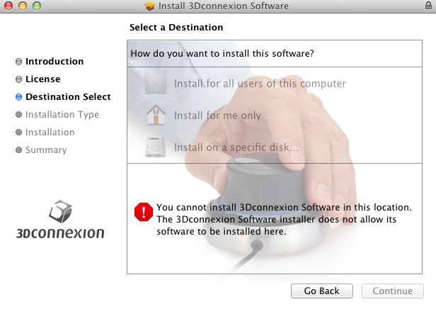

I identified the device as a Space Navigator and downloaded the driver. However when I tried to install the download I receive the notification with Destination Select :-
"You cannot instal 3Dconnexion Software in this location. The 3Dconnexion installer does not allow its software to be installed here"
The options, greyed out are :-
Install for all users of this computer
Install for me only
Install on a specific disc
Thanks for your assistance so far. I hope it is possible to get past this particular obstacle.

Re: 3D Connexion not working in SU
[attachment=0]screenshot_39.jpg[/attachment]
I was trying to install it directly on my Mac Pro which is running OS 10.7.5 . I am unable to use a later operating systems because I am stuck with 32 bit and cannot run 64 bit applications. As this driver is for an older 3Dconnexion device I didn't expect any problems, it used to work just fine on this computer.
The driver version I downloaded is 3DxWareMac_v10-4-1_r2428-2.dmg
Hello Limey,
we dropped support for OS X 10.7 with 3DxWareMac 10.2. You need a version before 10.2. Go to our driver archive and download 3DxWareMac 10.1.2. That should work for you.
Thanks so much for your assistance, the new driver works great and it is a pleasure to use this device once more.
