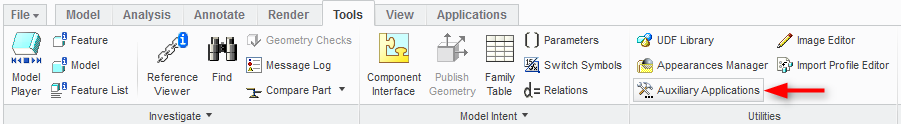

did you install all files with administrator rights?
Check if the plugin is loaded: go to Tools -> Auxiliary Applications -> Info and verify if you see the code for the plugin:
Code: Select all
Application 0: 3DxProENGINEER
Exec path: C:\Program Files\3Dconnexion\3DxWare\3DxProENGINEER64\creo3\x86e_win64\obj\3dxcreo.dll
Text path: C:\Users\username\AppData\Local\Temp\3DxProENGINEER
Version 33 - 2014190
Application is running.

Hello thx for your Response.
You are right it say that nothing is loaded in the Info Window. Yes i install on a Account that has Admin rights.
