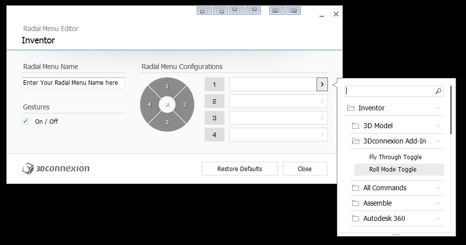

For anyone that finds this thread when trying to figure out how to "lock horizon" or use "contained orbit" with a 3D Connexion device, the option exists but is buried in the button configuration menus. refer to the attachment for the exact location of "Roll Mode Toggle".
This option makes a HUGE difference in navigation...
