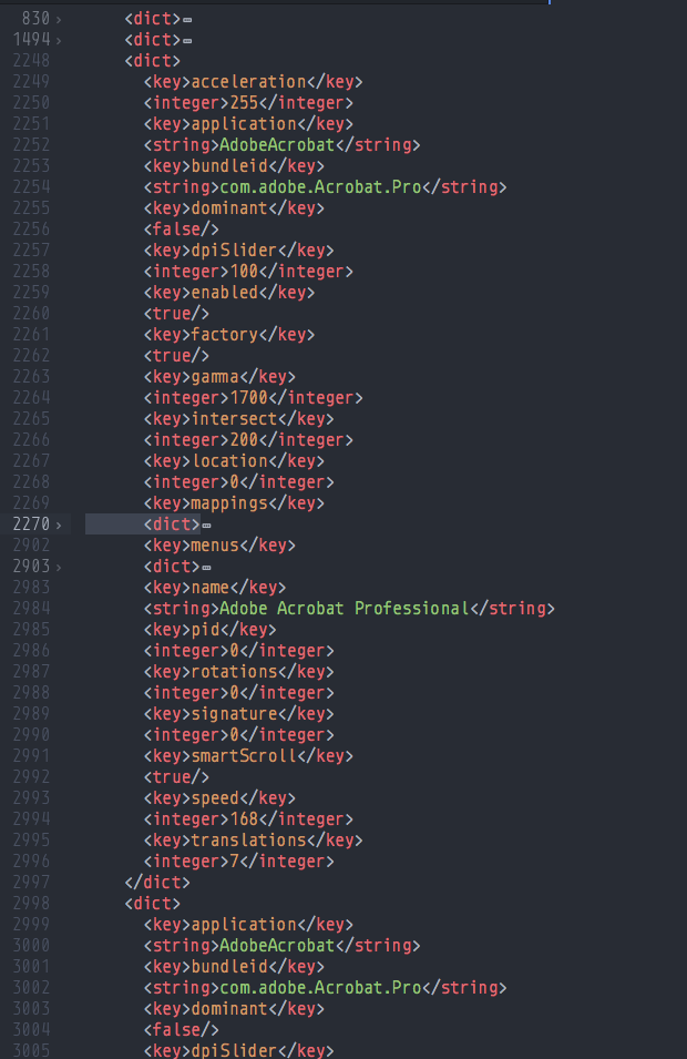

The process worked for me after several attempts, but proceed at your own risk:
The problem with the duplicate entries seems to be tied to modification of application specific settings. When modifications are made, the changes are saved as a duplicate entry in the 3dconnexion mappings configuration file. This leaves the user with two different configurations for a specific application, which renders user made changes un-usable. To fix this, I deleted the configuration file:
~/Library/Preferences/com.3dconnexion.mappings.plist
It took several attempts along with a reboot for this to stick. It seems that the 3dxware driver regenerates the configuration file when you open the dialogue box. Below is an example of the duplicate entries in the configuration file.
